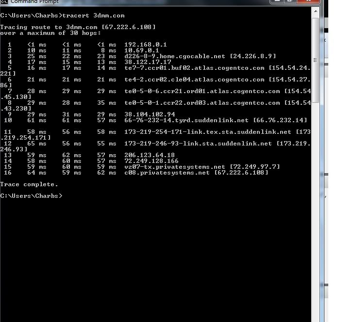

If you want, go to command window and type "tracert 3dmm.com", and send me a screenshot of the results (make sure you are not using OpenDNS anymore). I can then send it to my host, and they might be able to take care of it for you.

when i typed in tracert 3dmm.com it said
"Unable to resolve target name 3dmm.com"

Join Date: Sep 2001
Posts: 6,042
Sorry, I don't think they can do anything without a tracert. That is really weird, I expected it to be resolving to the wrong IP, not no IP. Who is your ISP?
I think there's a way to locally map a hostname to an IP address in windows. I'll see if I can find you some instructions on how to do that.
Space Goat is offline   Reply With Quote

it wouldnt tracert without open dns on
here is what it did with it on
[IMG][/IMG]

does this help
McJuicy is offline   Reply With Quote
Old 11-16-2011, 10:33 AM   #22
using open dns bypasses your ISP's dns servers, which is where the problem is, so probably not
